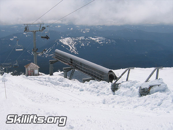

  • 18 Posts:
Posted 07 January 2011 - 08:03 PM
The Palmer Express is a fully detachable station used in during the busiest part of the summer for loading only. Rope flies over the terminal during the other seasons, but the lift is put to bed most winters because of heavy ice loads
