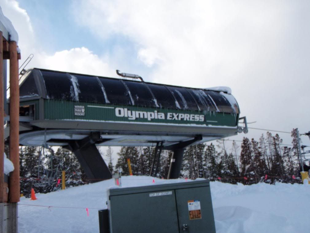

I was noticing how the terminals on the Challenger terminals at Winter Park are shorter than a normal Challenger terminal, like what we see at Breckenridge and Snowmass. So I wonder, how common are these terminals, since it seems that you mainly see the longer version?
Here we have Olympia Express at Winter Park with the "compact" version:

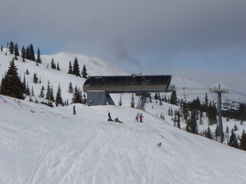

To compare, this is the Rocky Mountain SuperChair at Breckenridge with the same terminal model, just a longer version:
It seems that the latter is more prevalent, as I have only seen the shorter version at Winter Park, but are there any other areas that operate the short version? Also what is the reason of having the two styles and what are the advantages and disadvantages of each?

On the compact version, the speed is normally 900 fpm (even 800 fpm for some) due to a shorter acceleration/deceleration zone. From a topic about Norquay which has another compact terminal, here's Zage's description.
View PostZage, on Dec 28 2004, 03:00 PM, said:
The Pathfinder express is now caled the Mystic express and the terminal was custom made by Poma. It is one of the shortest hsq terminals I have ever seen. It is cool as soon as you sit down from loading, it accelerates you instantly.
For the acceleration, that is quite true. It begins to accelerate right as you sit down, and if you look up, you'll notice that the compression rail takes up the whole length of the terminal.
The regular Challenger terminals quite often had speeds of 1100 fpm and in a few cases even 1200. Mercury and Rocky Mountain do run at full speed often, but I guess only when it's crowded.

It feels like Oly does run a bit slower, but the main difference between the compact terminals and the more traditional types is that the accel/decel zones begin on the first tire out of the contour. On the longer terminals, there are five or six tires at the end of the straightaway that are all going the same slow speed as the contour, generally to allow for a longer unload or load ramp.

I'm not sure where the name 'Challenger' came from. POA called these lifts the Competition Series (1990-1998). The compact or short terminals were designed to run at 800 fpm (Zephyr Express @ Winter Park, CO) or 900 fpm (Olympia Express@ WP). The standard terminal was used for 1000 fpm (Beaver Run @ Breckenridge, CO), 1100 fpm (Alpine Springs @ Snowmass, CO) and 1200 fpm (Chile Express @ Angel Fire, NM). Thus the reference 'Competition 900' liftmech mentioned.
