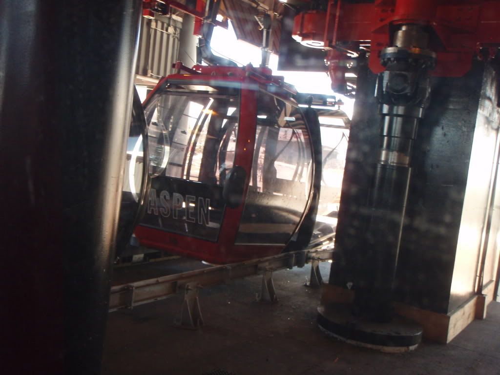

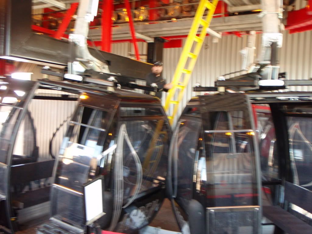

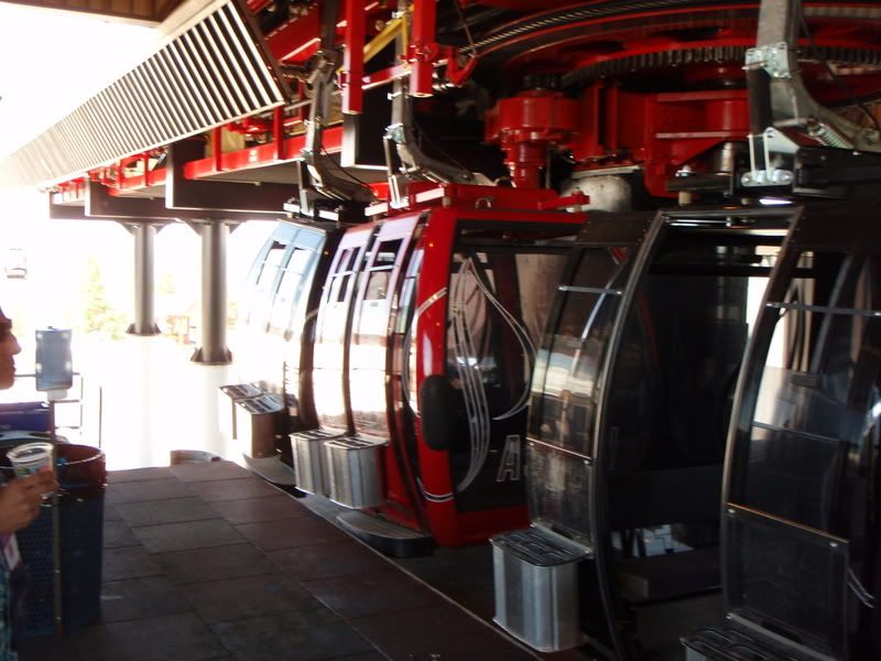

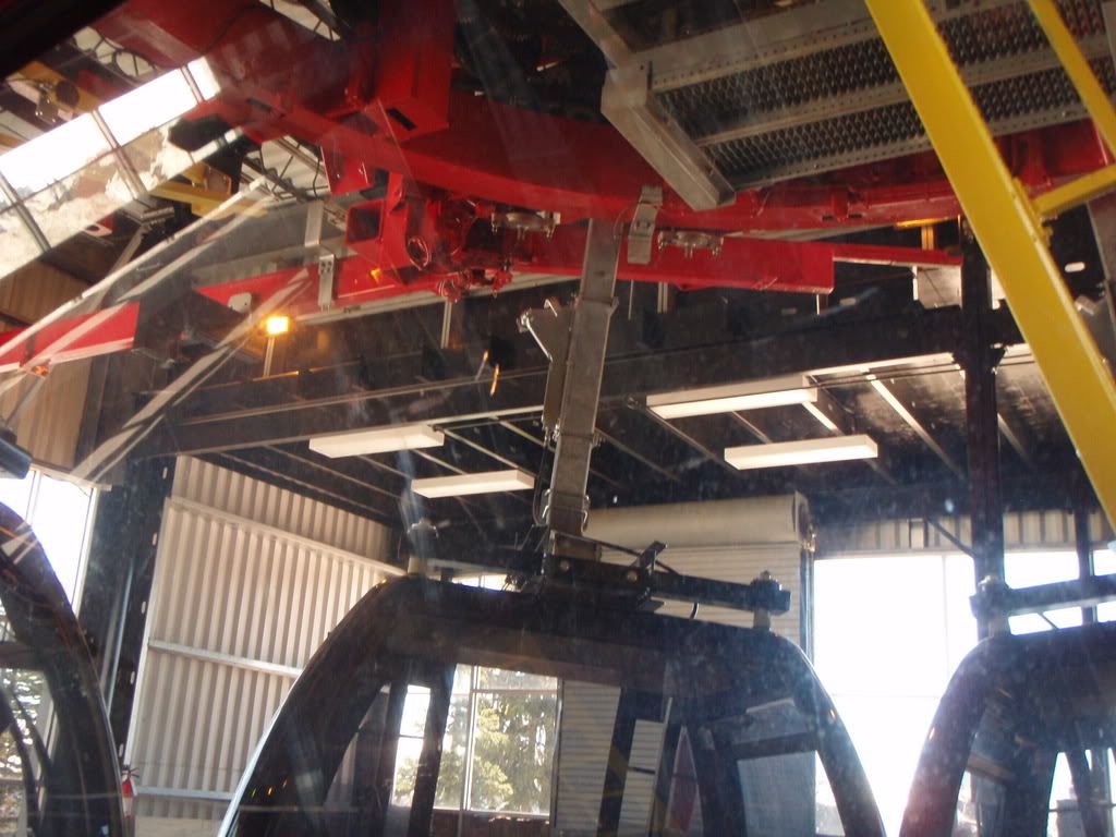

I was at Aspen yesterday and after the final day of skiing I boarded the gondola to ride down. Now we must remember that this gondola just got a new computer system and this was the first weekend of its use. At about the end of the contour (where the spacer is located) that section just stopped. I thought that maybe it was adjusting the spacing because I had seen some gondolas stop for a second and then launch the cabin. Well, I thought that until the next cabin ran into mine. And the next one. And then the cabin in front was already one tower out on the line. By the time the lift was stopped six or seven cars had run into each other at the top terminal. If one more car had come in, it would have been catastrophic since it would still be on the cable when it ran into the next cabin, and the lift would have had to be totally evacuated. As it was, lift maintenance reset the system, evacuated everyone in the top station, and manually pushed the cars around. So in the end what had happened? The frickin spacing clutch just stopped dead while the rest of the system was running at full speed. Evidently there are still some glitches to be worked out with the new computer system. (A patroller told me that only two people wrote the program that was being used.) In any case, I'm glad that I wasn't one cabin ahead and stuck on the line for 20 minutes. :tongue:
Now some photos:
Cabins stacked up along the contour:
Lift maint. coming to evacuate in the station (sorry all you can really see are the shadows):
The cabin ahead of mine:
The unloading zone:
Cabins stacked up:
You can't quite see the grips, but on the last two cars back, the grip needles were overlapping :shocking:
