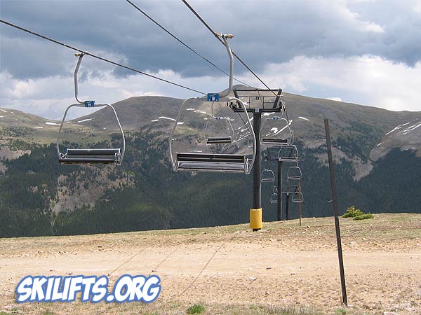

This first one was used between 1982 and 1985. It features an odd footrest which looks like a six-pack footrest. The people in the middle get two halves of a footrest. There are just a handful of lifts with these carriers remaining. This was taken from High Lonesome Express at Winter Park:

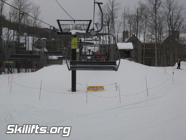

Also I have a photo of a 1988 lift, the White Peaks Express Quad at Waterville Valley, which used a unique terminal model as well as a slightly different arceaux carrier.
Note how the backrest and the seat are all divided for individuals, not all in one piece.

NHskier-- the carriers on the White Mt lift are the same as mine (1986), just that the pads are different. All carriers of those years came with the individual ones, but as they wore out some ski areas bought one- or two- piece pads to replace them. I have a single full-width backtest pad, but two seat pads.

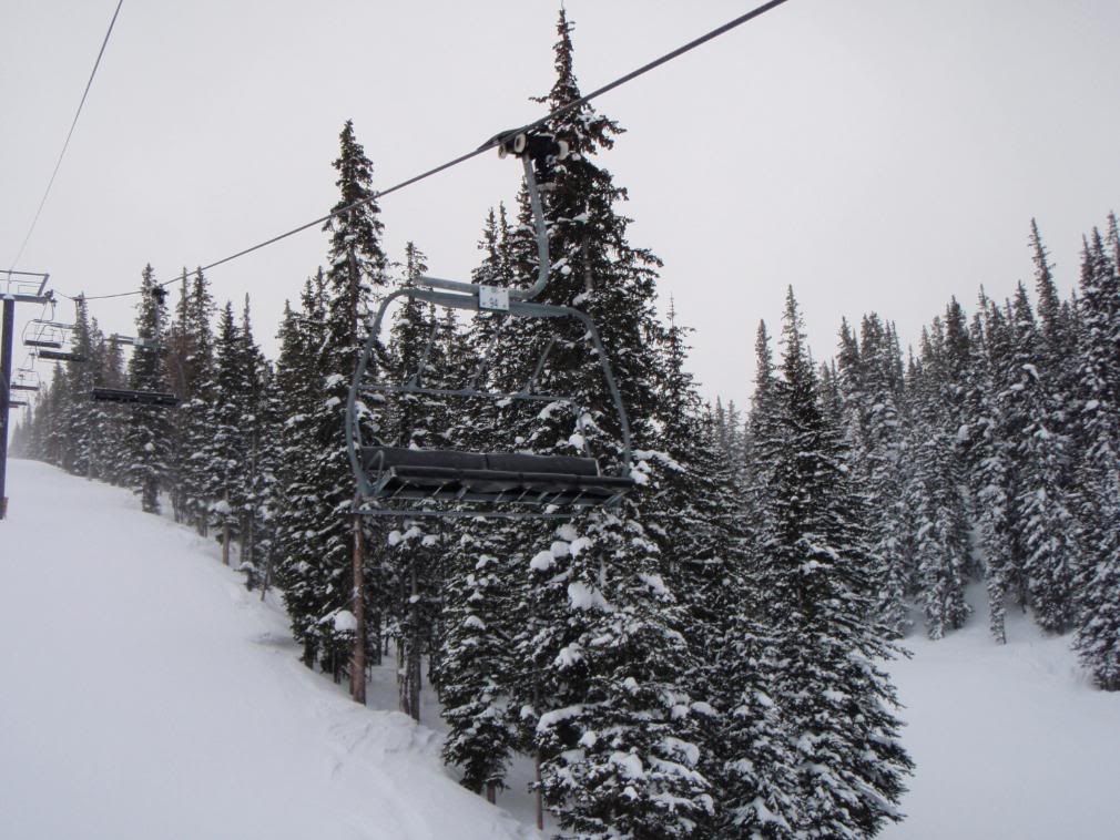

Also, there is another "type" of these, i've only seen them on the South Ridge B at Okemo, VT. I think one of the chairs at Copper, CO has them too.
B-Quad (Note there is only one of those thingies between the backrest and the seat, and the whole seat and the whole backrest is one piece each.

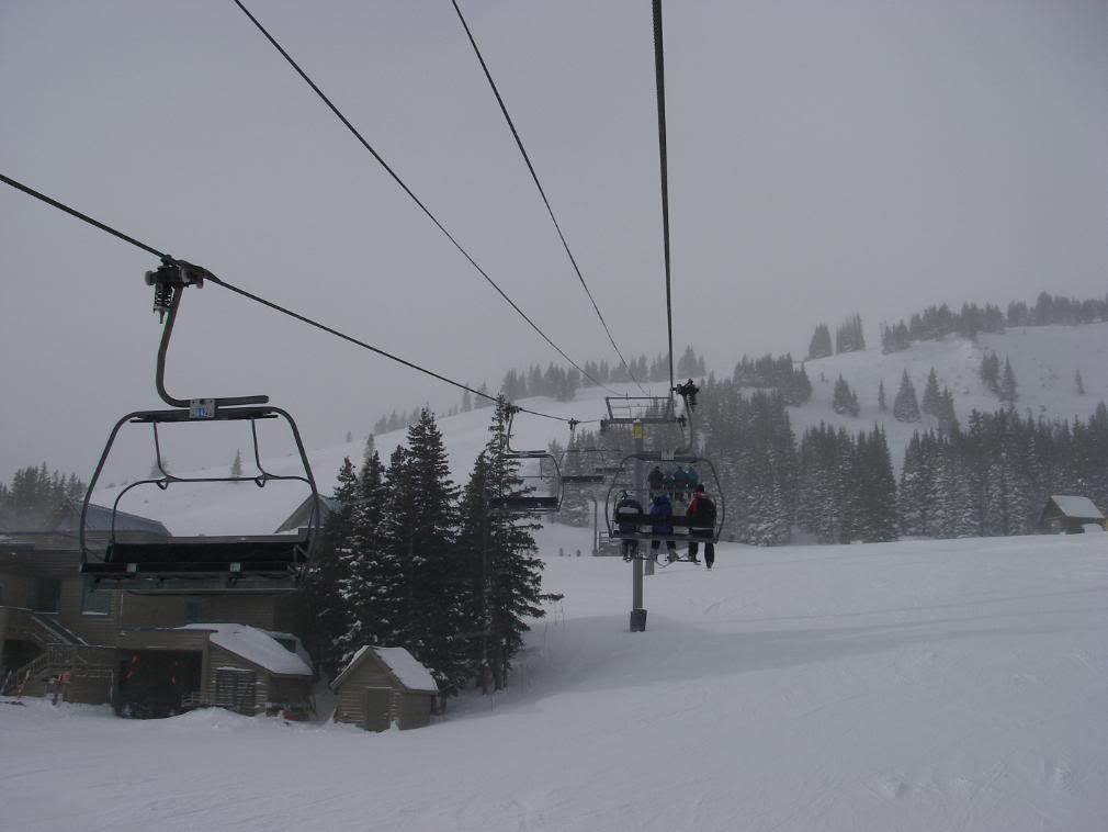

Here's another:
Also, there is another lift that I THINK uses the same carriers, I do not know exactly if this is true (Resoloution, Copper Mountain, Colorado)

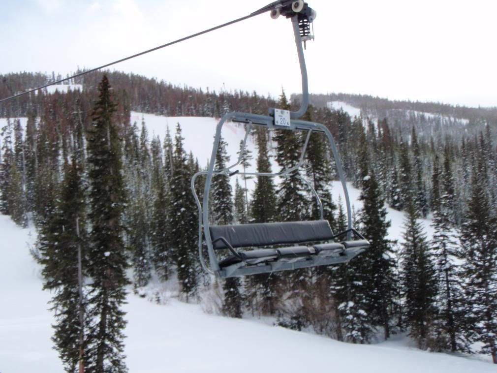

Ah. You've found the first version of the Arceaux, which had a single-unit 'basket' which had the seat pad and backrest bolted to it. Starting in 1986, Poma switched to a modular carrier design where the seat/backrest supports (we call them 'boomerangs') were bolted to a single 70mm box beam which was in turn bolted to the bail, or carrier frame. Much easier to maintain as broken parts can be quickly switched out. Here is a closer view of mine (courtesy of remontees-mecaniques.net, oddly enough I have no photos of my own)
