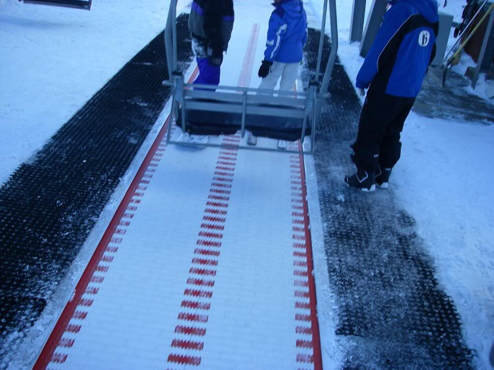

These things are horrible. They had one for a season at Crystal Mtn maybe 8-10 years ago and for a snowboarder it was tough. It is suppose to get you moving on the ground so the fixed chair (zipping along at normal speed) would snag you and there would not be as much of a jolt. I believe that is how it worked in theory but it would cause so many people to fall trying to get on the moving carpet the lift was always stopping..

technology changes quickly these days, an 8-10 year old system may considered prehistoric by some.
vidoes are available from both manufacturers.

I fully agree. We had load gates on both, as shoeman mentions, but those caused their own sets of problems. Both carpets were on return tension terminals; this didn't matter so much on Midway but on chair 9 both the carriage and the chairs would roll back on a stop (very dynamic lift profile) and that also caused problems. The carpet stopped as soon as a stop was hit, but the moving carriage combined with the chairs going back and forth caused many people to be knocked over. We covered that carpet with snow and returned it to a traditional ramp. Midway had trouble keeping the carpet synched with the lift speed; at first it would not slow down on a slow which caused all sorts of issues. Once that was fixed, the speed began to vary at random even if the lift was running steady. Once that was fixed, we began to have problems keeping the ice off the carpet. By the time we figured that out (poor heater and drain design in the vault) management got frustrated with the whole thing and removed both carpets.

this is something that I have experienced with loading carpets. I don't totally mind it, but it can get annoying.
Btw, Breckinridge has only one carpet. It's on chair 7 which skierdude posted a picture of!
