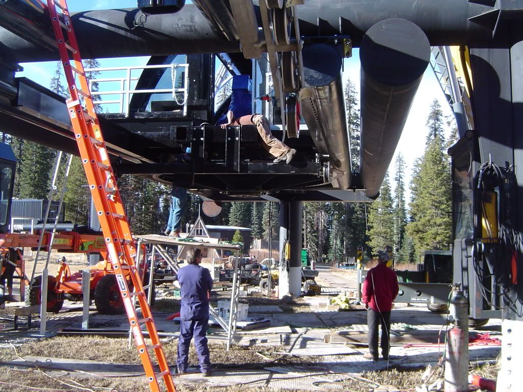

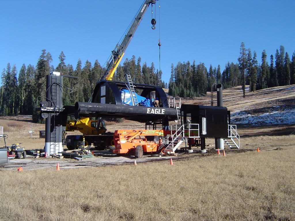

New Doppelmayr motor room on top of our old Yan adjustable bottom terminal frame, I took this photo earlier today. We should have the haul rope spliced before Thanksgiving.

Is the new motor room still gonna be vertically adjustable ? I like the doors on both sides of the lift shack.

EagleAce used to work here, she's on to bigger and better things now days. She would probably be thrilled to see what here namesake has become :) Since the bottom terminal is in the middle of a meadow, if we couldn't adjust up, it would end up in a hole during a big snow year and we don't have any snow making, so on a low snow year we would be in trouble. So, yes, the terminal is still height adjustable. We have a little hydraulic pump unit we throw onto a sled and pull out there with a snow mobile to raise or lower. The lift should be running on APU by the end of the week, just to hang chairs, then the sparkies get to go to work. We just wish we could have gotten a paint job on the reused parts before this season. It's a bit too cold to paint now, unfortunately. Note the control house is on the light side of the lift, this was so the back of it wasn't facing our lodge. I can't say enough about how the construction crew has kicked ass, this hasn't been the easiest job for them and they all want to be done for the year, but they are top notch.
