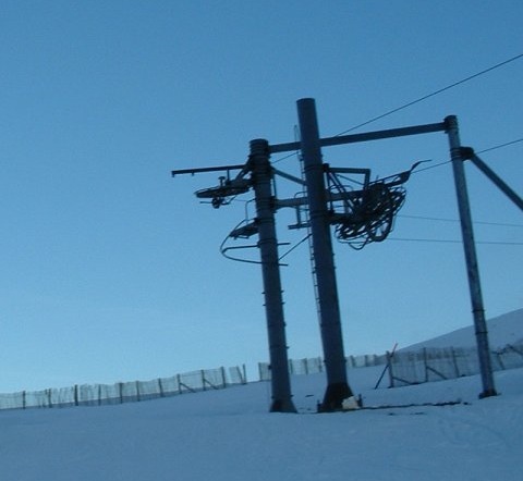

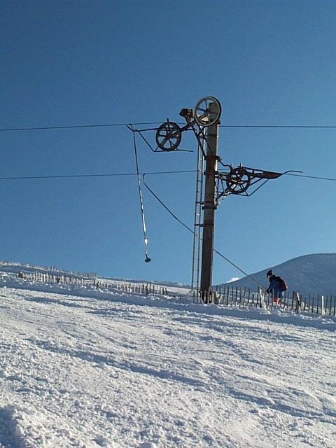

Does anyone have a photo of a platter lift with a bend in mid-line? I'm particularly interested in how the return line bends around the deflection sheave(s) with the detail of how the grip is twisted and held in the downward position to allow the rope free passage around the sheave(s).
On the platters with angle stations that I have seen, the downhill line does not follow the uphill line. It runs straight line fron the top back to the bottom.

I've attached a pic of a Poma platter lift with a much sharper bend than the one above.
The upline is on the RHS of the lift going up, in effect the hangers go round the bullwheel on the upline the 'wrong' way. This is possible because the grip has a very short arm, only a couple of inches or so and is then connected to the main hanger by a heavy duty spring, thus the hanger arm is guided by a the grove in the bullwheel, and metal guide rails.
In fact the grip arm is not long enough to keep the hanger clear of the sheaves on any support tower, this is down with guide rails which deflect the hangers outwards. Every now and then the wind will manage to get a hanger perfectly lined up so it misses the guide rail and follows the cable through a compression sheave assembly.... :helpsmilie:
This photo shows the tower sheaves and guides:

Great shots of up and down angle stations!
Skiersage- sure are a lot of U-Bolts in your pic.
