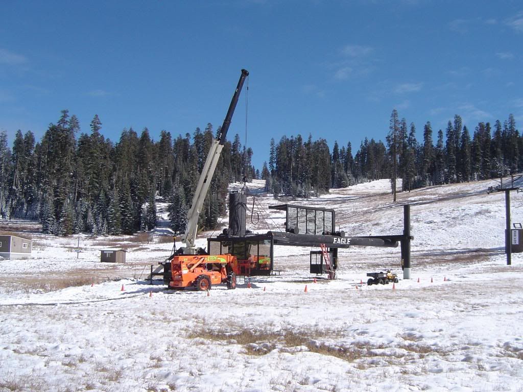

Badger's bottom terminal (drive) is going to be a Galaxy motor room on a Yan height adjustable framework and the return will be mounted on the Yan mast. Here's a pic of the Yan motor room being dismantled, the new unit will ride on a framework attached just inside the big tubes that say "Eagle".

What's the reason on why the Eagle lift is being replaced with another triple?
The lift doesn't seem that old if it's being replaced by one of the same capacity.

Multiple issues with carriers, grips and aluminum sheave trains both with our lift and with lifts at other areas. To keep the Yan in service, we were looking at major upgrades and it seems the ski lift industry doesn't want to assume the liability it would take to retrofit these lifts anymore. We are reusing the standing steel, the Yan towers are getting new caps and a much different profile, one tower is being lowered about 17'.
