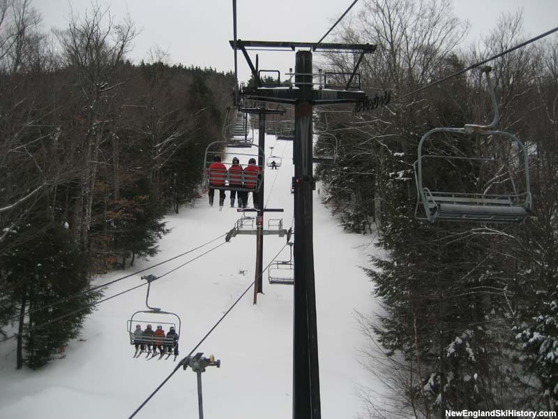

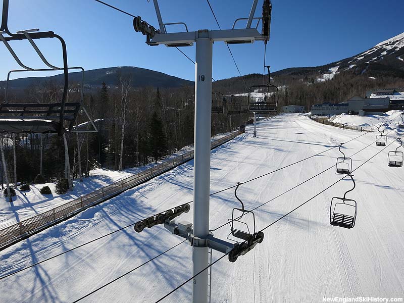

Snubber & Sawduster at Sugarloaf. (The only cross manufacturer combination I have seen)

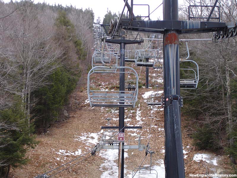

The Summit Triple & Flying Yankee at Attitash:

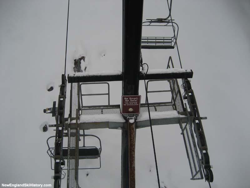

1. How is the tower extended to make way for the other lift crossing over on the same tower? I would assume that you either replace the entire tower, or add another tower tube on top of the old one if that's possible
2. How does the cross-manufacturer tower work? Does anyone know if the tower is stadeli or borvig?

1) The tower isn't typically extended, but replaced or added.
2) A modified assembly from one manufacturer can be bolted to another tower. Tower tubes are all fairly standard diameters.

At Attitash, CTEC put in that tower when the summit triple went in. At the time, it crossed the Old Reliable chair, a Mueller.

That Sugarloaf installation kind of evolved over time. Originally Sawduster, an early-70s Stadeli double, went up the right side of that slope all by itself, from the Sugarloaf Inn to just below the base lodge. In the mid-80s they realigned and extended it up above the base lodge, passing between it and another building. At the same time they built a new Borvig double, Snubber, from a little further down that ended across from Sawduster's base. In the early 90s they replaced Snubber with a Borvig triple on the same alignment, reusing the existing towers but significantly extended in both directions; it now starts way far down at the bottom of the condos and ends above the base lodge on the other side, crossing over Sawduster on the way. The common tower is Borvig with a Stadeli crossarm attached to it; I think they did it that way so that there's only that one tower in the middle of the beginner slope.

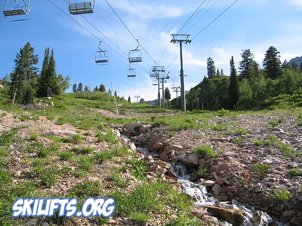

There's this one at Snowbasin. The Triple is the Porcupine lift. Not sure what the higher one is, though it looks like a Doppelmayr, likely to be one of the gondolas
#57 SkiDaBird
  • 509 Posts:
  • Interests:Skiing
Posted 14 March 2015 - 07:36 PM
Above is Needles Gondola
