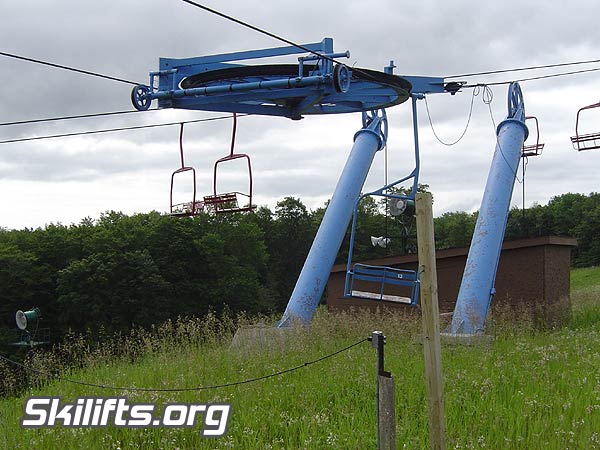

Andy1962's Photo Andy1962 10 Aug 2010
the attached picture of a floating bullwheel was taken from this link:
http://www.skilifts....=20
others will answer your technical questions, i know nothing except what I see.

william b's Photo william b 10 Aug 2010
I wonder if that ladder got regular use.

Petz's Photo Petz 10 Aug 2010
View Poststmad12, on 10 August 2010 - 05:28 AM, said:
I'm just wondering if anyone knows how a "Floating Bullwheel" Works.
There is no difference in the function cause it is tensioned with a weight like done at "normal" lifts too. But you save costs cause less steel and concrete construction is necessary.

Peter Pitcher's Photo Peter Pitcher 12 Aug 2010
Many Poma surface lifts have a floating tension return bullwheel. These surface lifts kept the bullwheel aligned with a cable mechanism on the counterweight side of the bullwheel. In chairlifts like the one in the picture, there were two stiff legs set at a 45 degree angle, with six deflection sheaves on the top of each one. The counterweight hung below these stiff legs and the bullwheel was held in tension between the counterweight and the rest of the lift. Because there were two points that the counterweight pulled on the bullwheel and the two points that the incoming haul rope and outgoing haul rope, it was very stable. However the downhill side of the bullwheel had to be supported on the haul rope by a pair of guide sheaves on each side. In the picture you can see these on top of the rope instead of on the bottom on a conventional return bullwheel. I am reasonably sure that the lift in the picture is an early Poma. Jean Pomagalski was very innovative. The ANSI code did not allow any floating bullwheels after about 1970, I am not sure why because they were very reliable. One problem was that the shock of the incoming grip on the depression sheaves caused metal fatigue in the supporting members which would crack. Miner Denver copied Pomagalski design and a number of their lifts had floating bullwheels. I think I may still have the plans for the Miner Denver floating bullwheel if you want to build one
